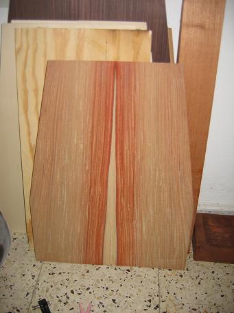

PostPosted: Sat Feb 11, 2006 3:33 am
Posts: 300
The pau rosa that Vachterm posted a photo of is the Swartzia fistuloides from Africa. That is the one that LMI used to offer. As has been said by others, it is an excellent tonewood. The comparison that has been made to African blackwood is pretty valid, except that it is easier to bend and, of course, the color is way different. The color is very similar to Brazilian tulip (a Dalbergia) and it is often called African tulip. I think I have about 100 board feet or so of perfectly quartersawn stuff in my wood stash. It also makes good fingerboards and bridges.

PostPosted: Sat Feb 11, 2006 4:20 am
Posts: 1075
First name: Coe
Last Name: Franklin
City: Decatur
I inquired about pau rosa at the local Woodcraft store last week, and the guy there shook his head and looked at me as if I were from Mars. Would they know it as Afrian Tulip? I might have a small blank of it to use for bridges, but want to be sure that`s what it is. The blank I havr looks alot like the outer edges of Udi`s pic. Very straight grain and even color.
